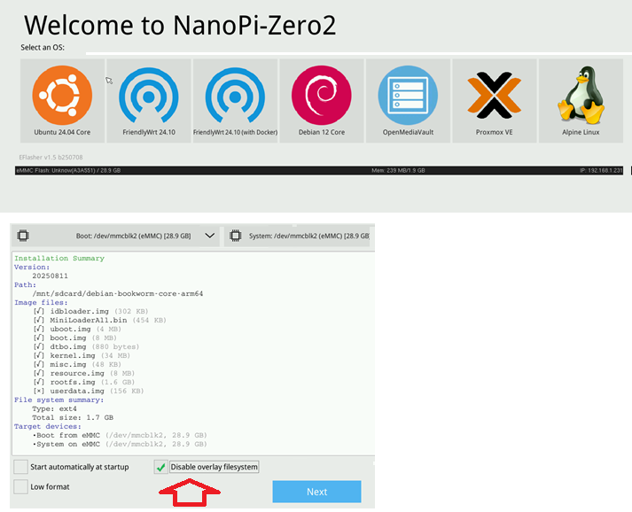

Fix was easy.
When flashing, select Disable Overly File System
