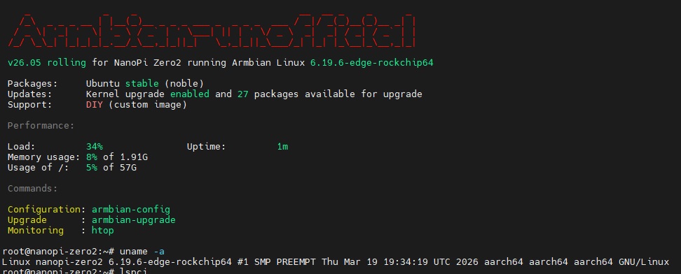

Kernel 6.19.6 Armbian
Actual status on https://github.com/drozdi70/linux-radxa
Still some issues with power domains/USB/PCIE but progressing.
Inviting to help/continue to work on... :)

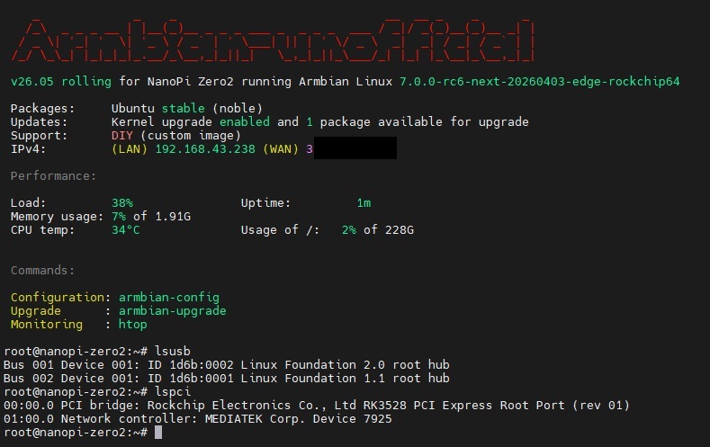

OK finally I was working with kernel version 7.0-rc6
Some tests made by myself:

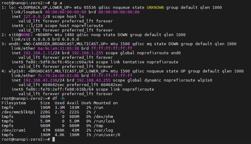

- initially image was loaded from SD card and next placed on SD with USB stick (USB checked)
- Armbian image was written to eMMC 256G and now it is booting from eMMC
- Ethernet end0 was checked locally with link to my laptop
- PCIE was checked with my wifi card is Mediatek 7925 as internet connection works too
