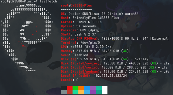

afaik there is no image for Debian Trixie, but you can use Debian Bookworm Core https://drive.google.com/drive/folders/142vQ7dGR2weEp1k55htKzZvl4vkcTizK and than upgrading to Trixie the tradtional way, see: https://linuxconfig.org/how-to-upgrade- ... st-version
Works for me without problems. :)
