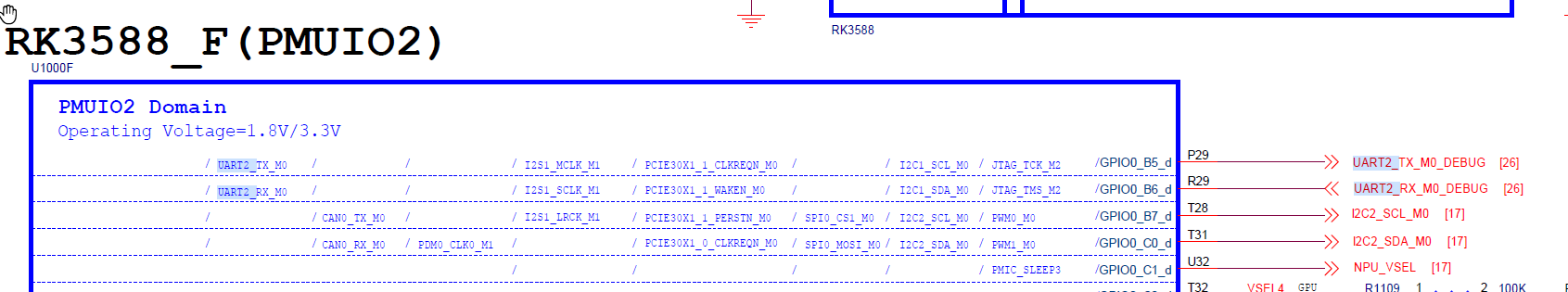

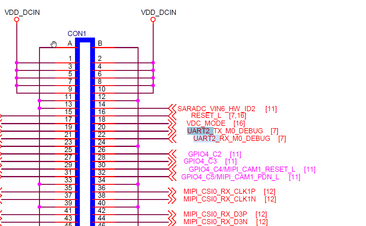

The Serial Setup - 1500000 8N1 prints garbage values on the serial monitor.
Any one knows if there are any other solutions ?
Re: Serial Uart Setting - Garbage Outputs
Posted: Tue Jan 07, 2025 11:40 pm
by EABASE
    1. That is a very non-standard UART baud rate. Typically you would expect standard rates of:
    [115200, 230400, 460800, 921600], on the serial debug interface.
    2. Make sure you're using a good serial to USB converter, as the clock divider need to be accurate and without noise.
    3. I cannot properly see the connections in the schematic, nor do I have any documents showing the inner UART diagrams. So without that CPU Reference Manual you can't know how the clock is used for the UART.
