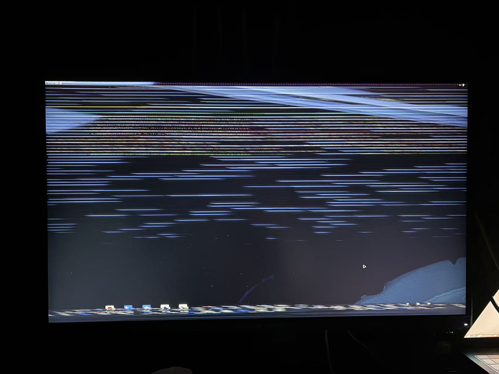

When I set the output resolution to 4K@120Hz in Android 12/14/TV, the screen shows significant display abnormalities (e.g., flickering, visual artifacts, or signal instability).But it works fine on Ubuntu Desktop, I checked the wiki and found that this problem has been fixed on Linux:
19.23 2024-05-22
19.23.1 Linux Kernel
Fixed the issue where HDMI output at 4K 120p was displaying incorrectly.
I returned the M6 ​​and bought the R6C instead, but the same problem occurred.So I think it's not a hardware issue but a system problem.
