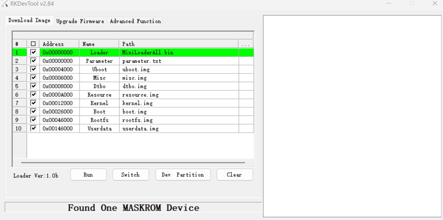

You need a USB A to Type C or USB to USB male to male cable to restore the firmware, is explained on the wiki https://wiki.friendlyelec.com/wiki/index.php/NanoPi_R6S , on a window pc download and install DriverAssitant_v5.1.1.zip, download rk3588-usb-friendlywrt-22.03-20230704.zip extract it and execute RKDevTool.exe,press and hold the “Mask” key and power on the device, you will see a “Found a new Maskrom device” click on Run wil restore the firmware
