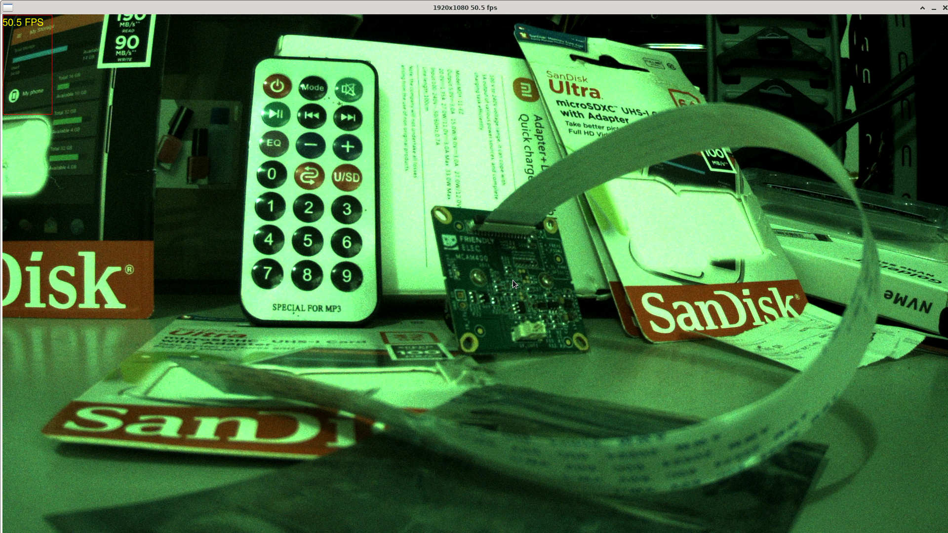

Now about ISP.
I'm not an expert in this topic. Unfotunately it's poorly covered, so I will tell in more detail, almost all that I know :).
Different Rockchip SoCs have different ISP (image signal processor), or, as they say, they have different versions of ISP. You can look at file drivers/media/platform/rockchip/isp/Kconfig in kernel sources and learn that version 1 was used in SoCs up to rk3399, version 2.0 in rv1126/rv1109, version 2.1 in rk356x. And ISP in rk3588 has version 3.0. These ISP versions use different APIs that are incompatible with each other. Of course, if you know appropriate API, you can setup ISP directly with your own application. But ordinary people :) use already existing opportunities. Typically OS already has some tool to handle ISP. In our case this tool is called rkaiq_3A_server. I use FriendlyCore image dated with 20230515 and I found there rkaiq_3A_server (or it was installed with some package later). But it seems not usable: when running it always crashes with segmentation fault. So I compiled rkaiq_3A_server from Firelfy repo (see attached archive). But that's not enough. We must learn ISP how to process data from our sensor. The bad news is that it hard to do! Sensors ans ISPs has many specific parameters, so settings for one sensor are not suitable for other one. Usually we use already existing files with such settings for specific sensor and, moreover, for specific ISP. I have not yet met settings file for OV4689 sensor for ISP version 3.0. So we cannot capture nice pictures from MCAM400. But we can at least learn how it works :)
When rkaiq_3A_server starts, it searches for available sensors and tries to find settings for them. Settings are JSON files (for ISP version 3.0) located in directory /etc/iqfiles. Name of file with settings consists of: driver name ("ov4689" in our case), camera module name (defined by parameter "rockchip,camera-module-name" in DTS file) and lens name (parameter "rockchip,camera-module-lens-name" in DTS). As I set value "MCAM400" for both these parameters in DTS, the filename must be: ov4689_MCAM400_MCAM400.json. Without this file ISP will not properly process data from camera.
Unfortunately we do not have JSON file for any ov4689 module. There exists OV4689 settings file for old version of ISP, as it works on rk3399 boards. It's in XML format, not JSON. Also there exists special converter iqConverTer that translates settings from XML file to JSON, but current version of this converter produces JSON files for ISP versions 2.0 and 2.1 only. And I'm not sure that translation to version 3.0 is easy to do. So we must hope that somebody will do this work for us :)
But now for learning purposes we can do a hack: get settings for some other sensor and see what happens :)
I took JSON file imx464_CMK-OT1980-PX1_SHG102.json (obviously, for IMX464 sensor) from the same Firefly repo (file with the same name from FriendlyCore is not suitable) and rename it to ov4689_MCAM400_MCAM400.json. Then put this file to /etc/iqfiles, put rkaiq_3A_server and librkaiq.so to some directory and started server from this directory:
sudo LD_LIBRARY_PATH=. ./rkaiq_3A_server
Server successfully started and began to wait for capture stream start. I set analogue_gain of sensor (see above) to 2000 and start capture of video (see the previous post how to do it). Picture from camera was bright but it occupied only about a half of frame height and was mirrored. So we can conclude that settings for IMX464 are not suitable for OV4689 :)
That's all.
Cannot attach the archive as it too large, so download it here: https://disk.yandex.ru/d/tPnXrLB5xSy0vg
It contains rkaiq_3A_server, librkaiq.so and fake sensor settings file ov4689_MCAM400_MCAM400.json.

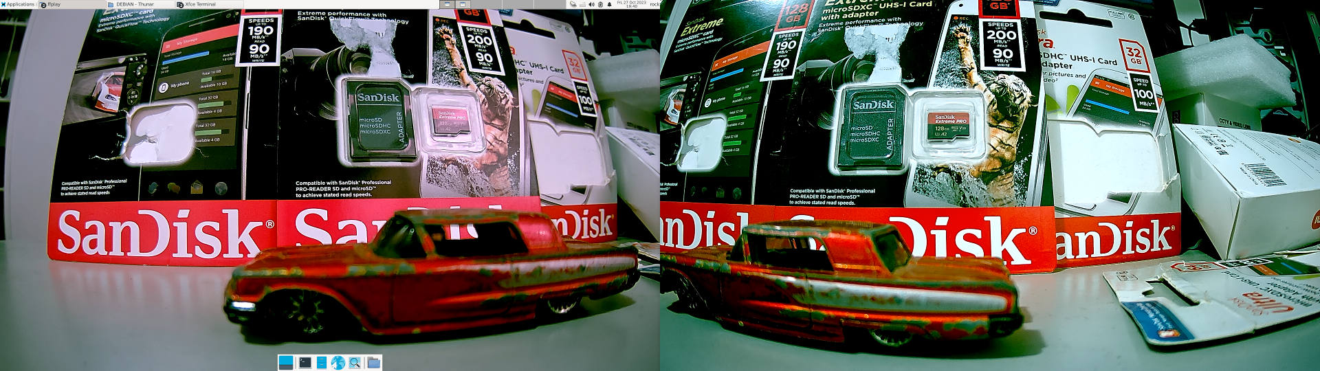

The next step.
Here is some preliminary version of JSON file with settings of MCAM400 for RK3588 (that is, for ISP 3.0).
Put JSON file from the attached archive to directory /etc/iqfiles and run rkaiq_3A_server (see the previous post).

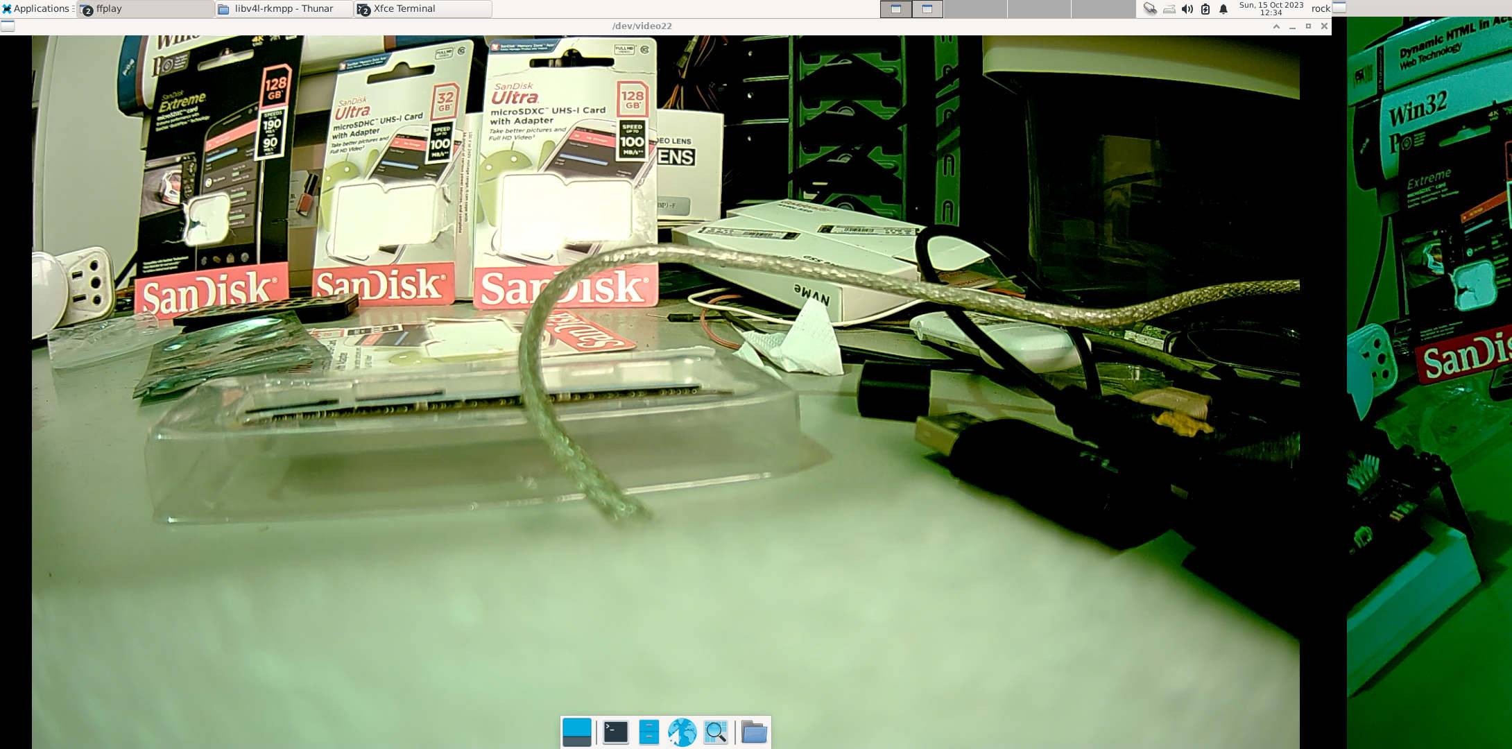

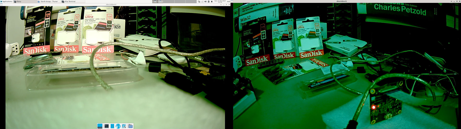

Now you can capture video from your camera. For example:
gst-launch-1.0 v4l2src device=/dev/video22 io-mode=4 ! video/x-raw,width=2688,height=1520,format=NV12,framerate=30/1 ! xvimagesink
Colors are not perfect, but at least you will be able to understand what is displayed by camera :)
This JSON file uses static exposure and gain. You can find their values in section "LinearAeCtrl" / "InitExp":
"InitTimeValue": 0.03,
"InitGainValue": 8,
These values correspond to exposure 1399 and analogue_gain 1012 that you can obtain from sensor with command:
v4l2-ctl -d /dev/v4l-subdev2 -C analogue_gain -C exposure
You can change these values in JSON file (and restart rkaiq_3A_server) or modufy them on the fly:
v4l2-ctl -d /dev/v4l-subdev2 -c analogue_gain=2000 -c exposure=1500
I do not know how to setup ISP for automatic control of exposure/gain, color enhance and so on. There are too many parameters here that I don't understand :) . May be more qualified person can do it for us.

I just received the board and i was able to test and grab some images.
I rendered the frames at ~25 fps, so 3A is possibly capped at 30 fps. Maybe with libcamera one can have 120 fps, but I am not really sure if the driver can get 120 fps. I kept the original driver and added the 120 fps patch, maybe i did something wrong.
I was particularly interested in the dual-camera setup but the second camera image is dark and greenish, kind of.
i think FriendlyElec should invest in tuning the camera.
Here is what i get:
Camera 1 and Camera 2:
Fixed my 120 FPS mistake, I can't have other modes (or I couldn't find a way to set 120 FPS mode as the current mode).
Camera 2 ( CSI-1 sensor with IR filter), 120 FPS, rendering frames at ~50 FPS.

By adjusting analog_gain and exposure we can get pretty nice images. see cam1 vs cam2 screenshot attached.
cam1 (left) : w/o IR filter (3.3 mm F2.2)
cam2 (right) : w IR filter (3.6 mm F2.0)
