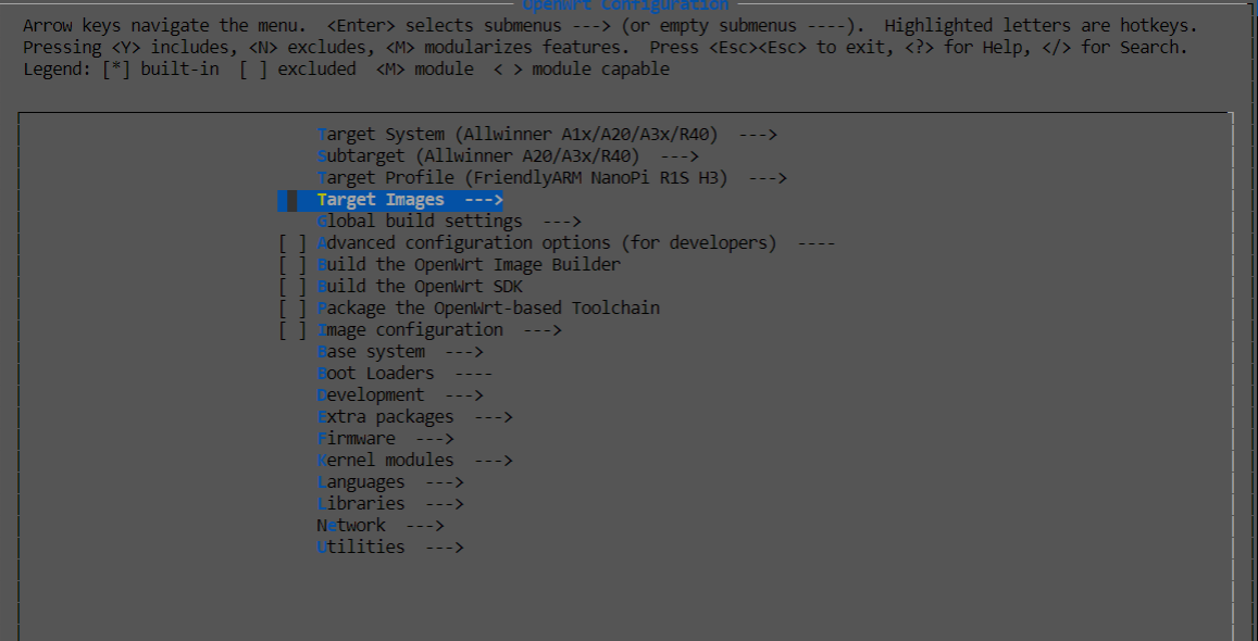

Here is the source code for openwrt with NanoPi R1S-H3 added.
Follow the normal procedure of compiling OpenWrt.
You can also use Github Actions to compile builds:

Thanks ... i dont have x86 with linux ... so yestrday i start building on RPI4 (my first build openwrt :-D ), image are done. Today i will test them if they are OK.
I hat little problem on start because i overloked the diferent branch on GIT. But at the end i find my way eventualy.
Building on RPi4 would be super slow. I suggest you use GitHub actions with ssh or CircleCi with SSH. Meanwhile, you can also use:
https://github.com/jayanta525/build-openwrt-nanopi-r1
this NanoPi R1 build by me. It should work fine with the R1S-H3. Once you confirm it boots, you will need to compile the wireless drivers available seperately.
it was cca 7h so it was not so hard . I dont know how to use github action.
I only add luci , openssh and some additional small stuff . But i dont compile rlt8812 driver for now (for test) du i must compile it or it will be awalible to download like kmod ?
so id dosend work ... even you precompiled img dont work.... i can conect to device ... it gives mi wierd ip 169.254.56.172 web base luci dont running and ssh dont accept empty passwrd.
the r1s-h3-h5 build wifi dont runn so i think it dont boot properly.
