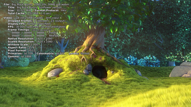

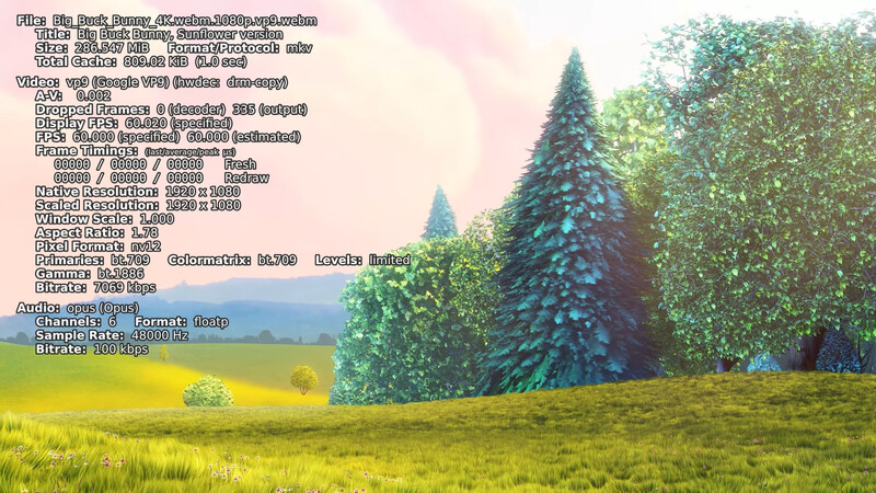

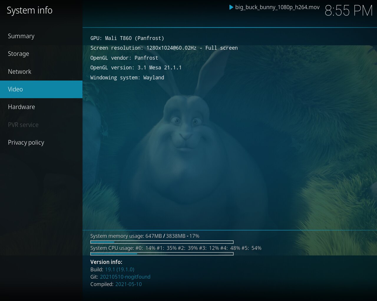

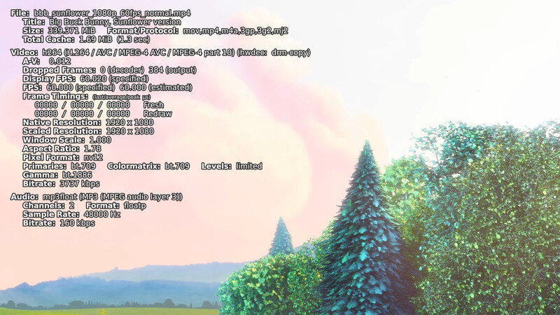

Hey, good job on this :D . It runs absolutely smooth. Also youtube playback with the web browser Falcon is very smooth. Browsing through the web feels more like it should be - less laggy experience.
Glmark run very well without stuttering - looks like it is hardware accelerated.
Kodi also runs very good. With hardware acceleration of course. But did'nt test 4K yet but I will asap.
I doubt that it will be hardware accelerated as I know ffmpeg mainline is missing some support for it. LibreELEC is carrying some patches for it, but they are on some older version. I. e. I am not aware of suitable patches to rebuild the package. I'm not sure if Kodi also requires some love or if kodi-19.1 is sufficient. It is just pushed to stable (update report) and "dnf upgrade" will probably pull it in.

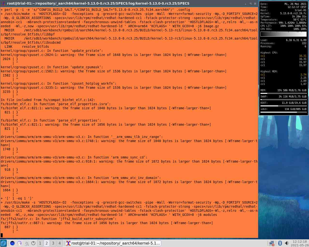

supergordon wrote:
I have like 20 browser tabs open, pdfreader and the terminal and nothing lags. everything is promptly loaded.
The same goes for me, but I'm also building the kernel package on the second desktop at the same time.

I have now ffmpeg with these patches applied in place.
External libraries providing hardware acceleration:
cuda                    nvdec                   v4l2_request
cuda_llvm               nvenc                   vaapi
cuvid                   opencl                  vdpau
ffnvcodec               v4l2_m2m                vulkan
But as I don't know how to verify the hardware acceleration, I'm not sure if something else is also required.

Now also applied LibreELEC kernel patches and rebuild ffmpeg with v4l2-request-hwaccel support. gst-play-1.0, ffplay and mpv now play bbb_sunflower_1080p_30fps_normal.mp4 with similar achievement.
VP9 support has just landed in media staging, i.e. is in flight for 5.17.0. I moved to 5.16.0-rc2 with media staging patches applied.
"mpv --hwdec=auto --hwdec-codecs=all ${MOVIE}" successfully supports various hardware accelerated codecs (hwdec: drm-copy):
Gstreamer main branch has just landed VP9 support, i.e. 1.20 should have it out of the box.
Kernel 5.16.0-rc5 still requires this regression fix for RGA support.
