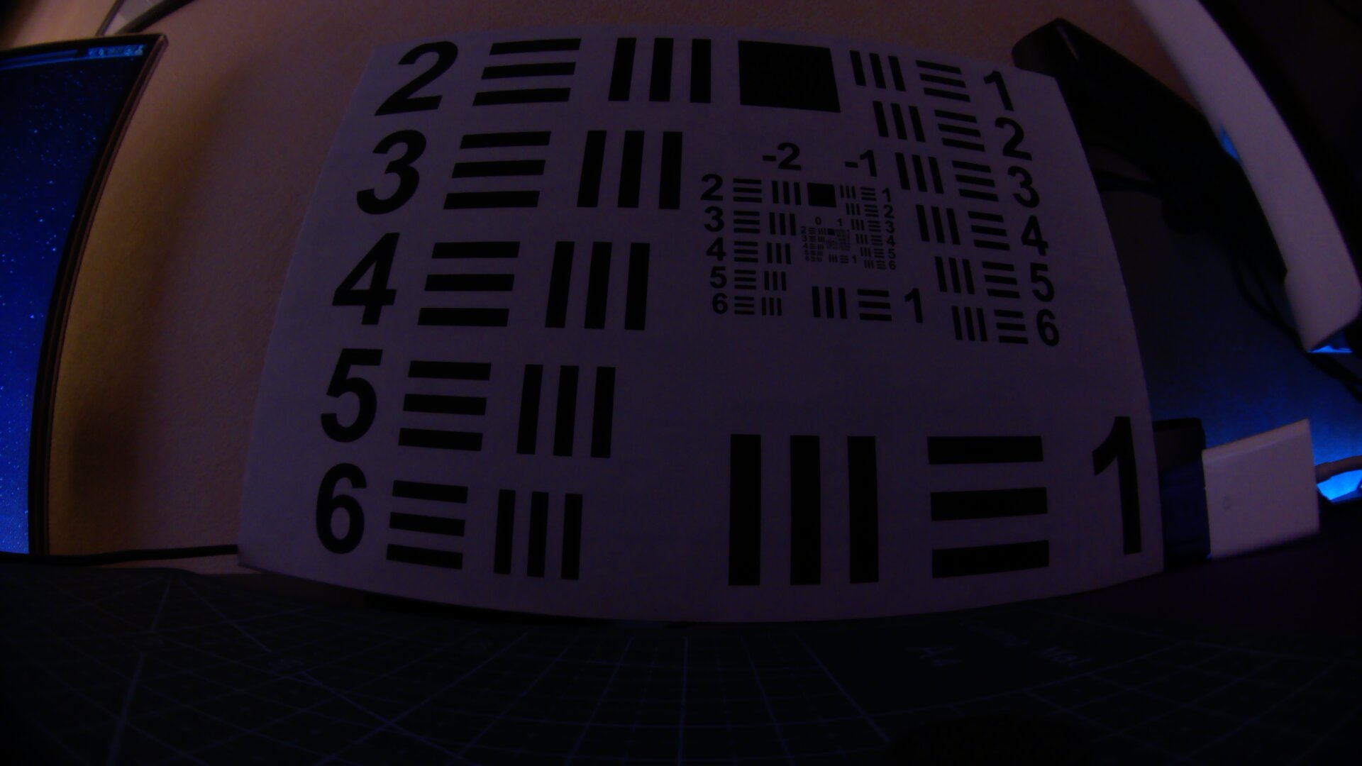

I use the MCAM400 with a nanoPi M4 (image rk3399-sd-friendlydesktop-bionic-4.4-arm64-20201027).
Image is very dark when there is not much light so I think there is no AEC or AGC.
Do you know how I can enable it if there is ? Or do you know how I can access to registers to set gain by myself ?
Thanks for your help.

I changed the lens to have more angle and with current image (rk3399-sd-friendlydesktop-bionic-4.4-arm64-20201226.img.zip), camera output is very dark (photo in attachment).

Changing the lens will not help. You need the 3A and set Exposure / Gain somehow. 3A is a closed source, Maybe contacting Rockchip or FE would help.
Libcamera has evolved and there are some tricks to get a descent Image but far from what you get in 4.4. If you master how to pass the correct EXPOSURE / GAIN in the rkisp demo engine, please post here.

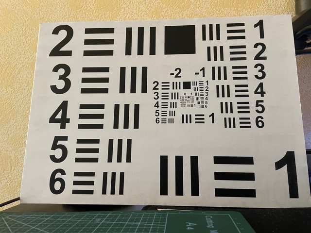

I didin't miss your answer - plz, use 4.19.111 to be sure, that it works(or make sure, that's nothing broken between 111 and 161 version in RkISP(kernel part) and OV4689 driver(it's 2 places in repo)).
I will upload images later today or tomorrow

Sorry for really delayed answer - just manage to get to hardware - please find follow examples:
- auto(gstreamer)
- manual: exposure 0.01sec, gain(analogue) 8
- manual: exposure 0.01sec, gain(analogue) 16
- manual: exposure 0.029sec, gain(analogue) 8
Looks like I can'ts add link to images from google drive - so link to folder with them - parameters coded in file name

Right, still dark and a lot of noise. Anyway, we know now the FE distro works but I was expecting to have a bit more exposure.
Can you print your command line and the output of the command? For the record. There are two MCAM400 cameras (w/IR and without), which one do you have?

Thanks, i am able to pass the correct params with kernel 4.19.161 and have a bright image, really bright :).
Just need a better denoise filter, just as the FE 4.4 has.
./rkisp_demo --device /dev/video0 --count 15 --width 2688 --height 1520 --format YU12 --gain 2 --expo 0.031 --output test_gain2_ov4689_2688x1520.yu12

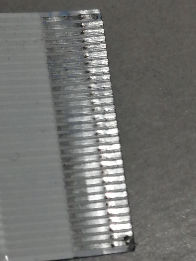

Unfortunately, I can't make the camera with IR cut works with 4.19.161 and the mainline kernel.
That's why I asked you which camera you tested with. the Camera w/IR cut filter worked fine with FE 4.4, maybe I have damaged the sensor removing and inserting it many times.
I get this error:
[ 72.944191] rkisp1: MIPI mis error: 0x0000000e
I get this error:

Just for the record, i just received a new sensor and found out the error reported here is due to a short on the last track of the FPC, luckily the sensor was not damaged. Changing the FPC was the fix.
[ 72.944191] rkisp1: MIPI mis error: 0x0000000e[/quote]
