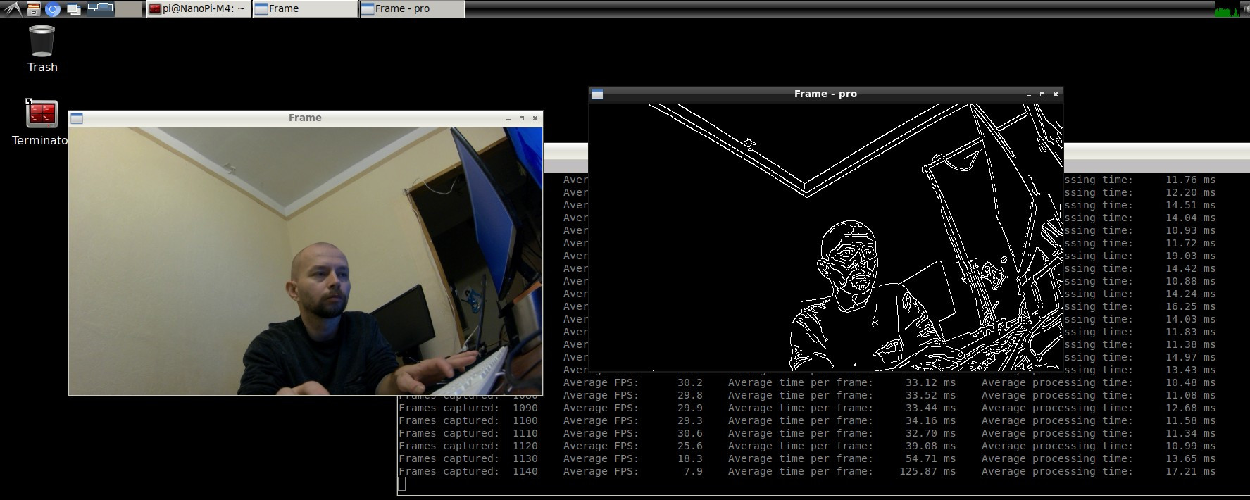

simple screenshot from OpenCV test on NanoPi M4/sdcard you can find in attachment
Unfortunately, framerate can't be changed and it's always 30fps)
