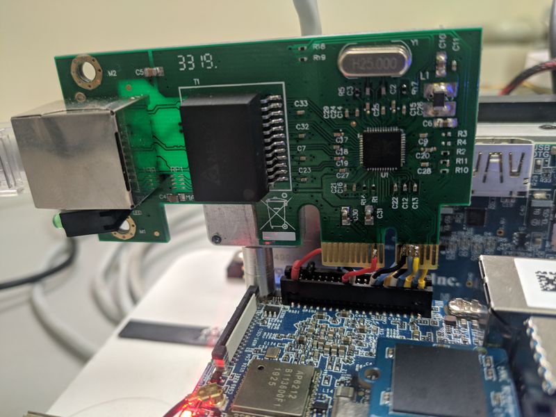

I was finally able to enable Realtek RTL8111F PCIE x1 GbE network card utilizing Nanopi-Neo4 GPIO 40 pin slot. It seems to be working as expected. Armbian Focal / kernel 5.6.14
Only 8(9) wires used:
PCI-E TX0n/TX0p - 1 pair
PCI-E RX0n/RX0p - 1 pair
PCIE_REF_CLKP/CLKN - 1 pair
GND, 3V3_SYS - connected to 3v3 and 3v3 AUX on realtek card.
I guess separate 3v3 voltage regulator should be used instead of engaging 3V3_SYS pin.
Patching dtbs was required in my particular case:

It was definitely bad idea to use 3V3_SYS as PCIE card power supply. So i connected 5V to external 3V3 LDO and used it as realtek card power supply.
I was able to boot with Armbian 20.05.2 Focal / 5.4.43 and PCIE card seems to be working.
Seems like my setup has some problems with PCIE soft reset, engaging pci express device reset pin with additional wire solved this issue.
Device tree changes for my setup:
&pcie0 {
   ep-gpios = <&gpio1 RK_PA4 GPIO_ACTIVE_HIGH>;
   max-link-speed = <1>;
   num-lanes = <1>;
Default DTS ep-gpios referenced to gpio2 PA4 which is not connected anywhere on the Neo4/M4 board according to schematic.
I used gpio1 PA4 instead (pin 15 GPIO1_A4(3V) on 40-pin GPIO header) and wired it to #PERST (reset) pin on realtek PCI-Express card.
I am not sure that forcing to PCI-E 1x speed is necessary for any setup, sometimes it boots with x2 configuration.
