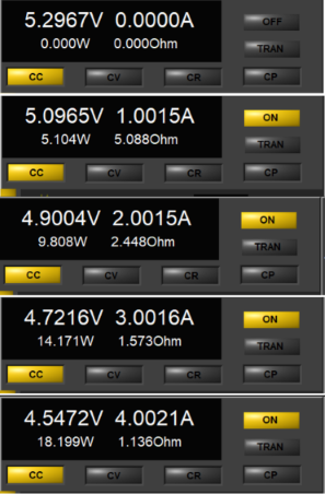

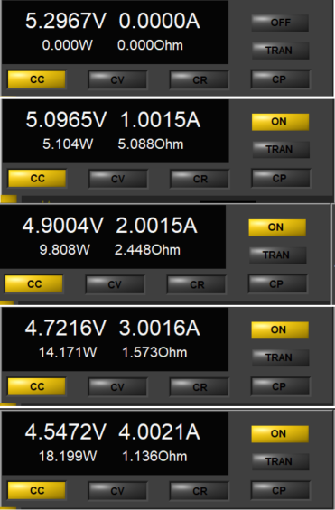

Very much the case. I got 2 power supplies from a local supplier, non branded Chinese models. Both were claimed to be 5V 4A and 5V 5A but ended up being useful only at 5V 1A before they dipped. I ended up getting some Meanwell supplies from Mouser that have a far more stable output.
The choice from FA to design now with onboard regulation and using 12V input is a good one as this removes the issues were a
lot of users have failures due to the 5V supplies being insufficient to power the devices. You see that a lot with Raspberry Pi.
