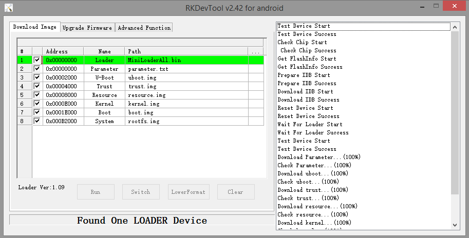

Impossible load images of the web correctly by Type-C
I tried to load friendlycore without result (the image loads on the card, but the system doesn't start). However, Diet-Pi image works without problems.
Attached capture with my parameters in case I have something wrong. On the wiki, I can see only the Android and DietPi values (captures).
Regards.
I've got it working modifying the last line of 'parameter.txt' to:
CMDLINE: root=/dev/mmcblk1p6 rw rootfstype=ext4 mtdparts=rk29xxnand:0x00002000@0x00002000(uboot),0x00002000@0x00004000(trust),0x00006000@0x00008000(resource),0x00010000@0x0000e000(kernel),0x00010000@0x0001e000(boot),-@0x000B2000(rootfs)
