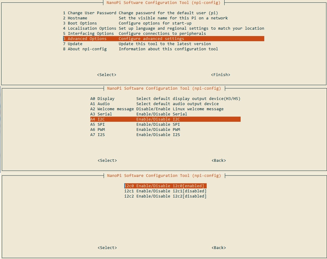

Now we take a look at the NanoPi Software Configuration Tool (npi-config), because we want to know I2C is enabled, or we have to do so.
sudo npi-config
First select 5 Advanced Options, then select A4 I2C and last select i2c0 Enable/Disable.
npi-config I2C.jpg (149.03 KiB) Viewed 44037 times
If i2c0 is enabled, you can leave the menu. otherwise enable it and reboot.

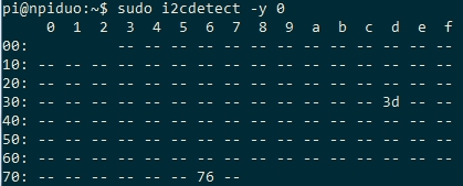

If we have installed one ore more I2C devices on our NanoPi, we can check there addresses out now.
pi@npiduo:~$ sudo i2cdetect -y 0
(Address 76 is a BME280 and address 3d is a Char OLED.)
