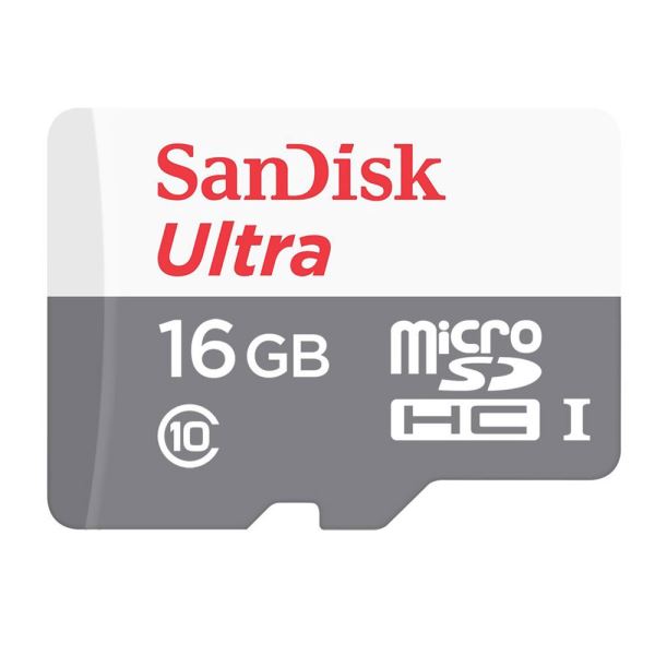

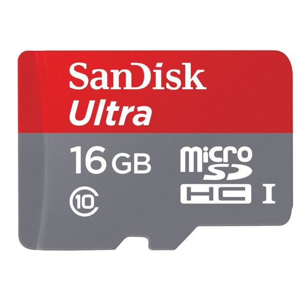

Looks like a bad or really slow MicroSD-Card.
Which card you you use? Brand? Speed?
Iam using a Sandisk Ultra 16GB , Speed: Class 10, 80MB/sec (grey/red - the white/red has only 48MB/sec)
