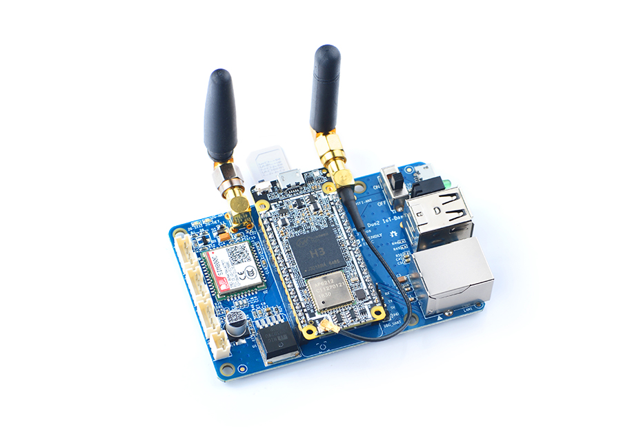

NanoPi Duo2 IoT-Box not working?
I want to use my NanoPi Duo2 with the NanoPi Duo2 IoT-Box, but nothing on the board works...
Power on...
Power LED (red): on
LAN LEDs flicker only for a short periode and then off
On the console:
>> sudo ifconfig eth0 down
>> sudo ifconfig eth0 up
Shows no error (0)
Short:
No USB
No LAN (No DHCP requests)
No GSM
Has anybody the same problem?
Is the IoT-2G Application Carrier Board wreck?
Regards
