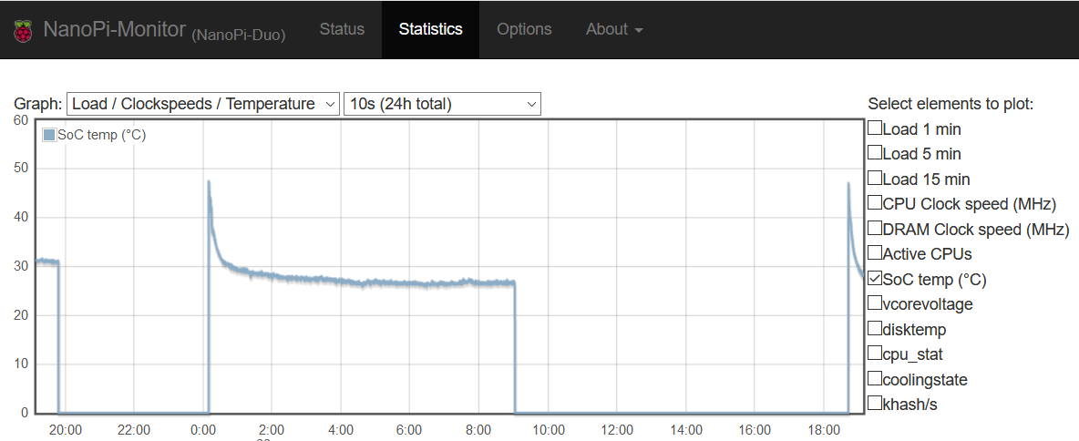

Hi, I use a Nanopi Duo with heatsink as Flightradar 24 receiver at the top ground. It works fine. But sometimes the Duo is not working. I can only interrupt the power supply. Then the temp is very high:
NanoPi Monitor is also not working - no readings. Has the Nanopi Duo a watchdog? So it can reboot, if it is not working anymore. If yes, how can I activate the watchdog?
