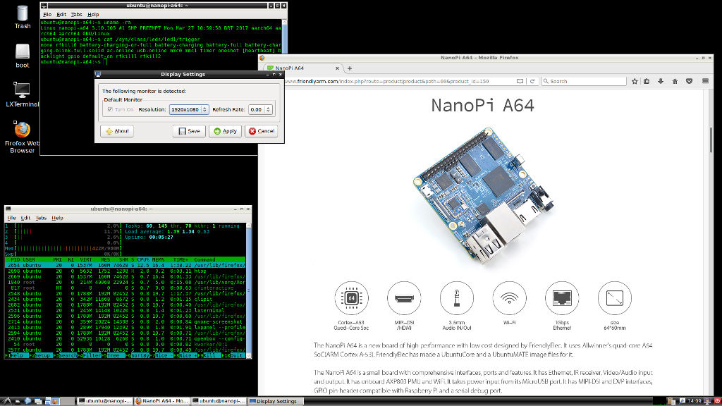

I also switched from 1080p to 720p
cd /media/ubuntu/boot/a64
cp a64-2GB.dtb a64-2GB.dtb_1080p
cp a64-2GB.dtb_720P a64-2GB.dtb a64
reboot
Now my NanoPi A64 is updateing the xenial via apt (170MB to go)....
Welcome to Ubuntu 16.04.3 LTS (GNU/Linux 3.10.105 aarch64)
Linux nanopi-a64 3.10.105 #1 SMP PREEMPT Mon Mar 27 10:59:50 BRT 2017 aarch64 aarch64 aarch64 GNU/Linux
