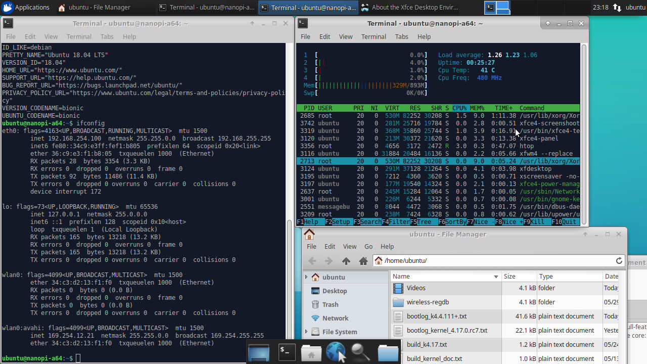

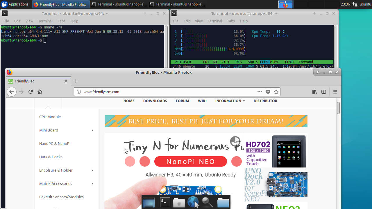

As you can see, firefox is memory hungry application, add this to the bionic and 1 GB mem is almost full.
[attachment=0]a64_kernel_4.4.111_2.jpg[/attachment]
[attachment=1]a64_kernel_4.4.111+.jpg[/attachment]

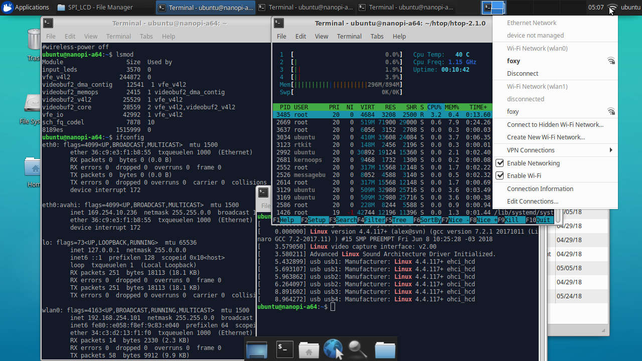

The RTL8189ES driver has been fixed for kernel 4.4.117, it is working fine on a few tests here. I will push the source code to github after proved stable.
[attachment=0]wifi_rtl8189es.jpg[/attachment]
