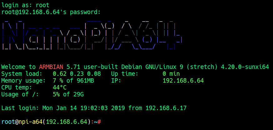

In the meantime I did this experiment and edited the pin64-boardconfig inside the armbian-build-system for the NanoPi A64,
because the complete build-system did have a .dtb and defconfig-file for the NanoPi A64:
./build/cache/sources/u-boot/v2018.11/configs/nanopi_a64_defconfig
So - please - take a look at
https://forum.armbian.com/topic/9308-ex ... anopi-a64/
Maybe - with some other users & helping hands - we could get a better (unofficial) armbian-build for the NanoPi A64
