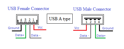

Do you got the right colors at the cable (black, red, green and white?)
Did you think about that the female header is in the other pinout-direction as the male header (see attachment)?

1. Reconnected as follows
USB pin 1 -- Red --- Nanopi pin 1 ---- VDD5V
USB pin 2 -- Green --- Nanopi pin 2 ---- USB-DP1 (D+)
USB pin 3 -- White --- Nanopi pin 3 ---- USB-DM1 (D-)
USB pin 4 -- Black --- Nanopi pin 12 ---- GND

Reviewing all of this, the problem may have been caused by poor electrical connection on the D+ side, there was some contaminant inside the female pin header during continuity test.
