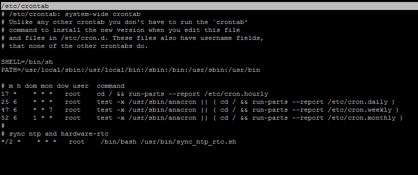

well, so I found reason of my problem by myself :)
all is about CRON job, last line from /etc/crontab
*/2 * * * * root /bin/bash /usr/bin/sync_ntp_rtc.sh
- that mean that this scrip will run every 2 minutes
solution: I have changed this line to run every 24 hours
* */24 * * * .....
or it is possible to disable send email notification (I didn't test it) by adding at the end of this line
>/dev/null 2&>1
