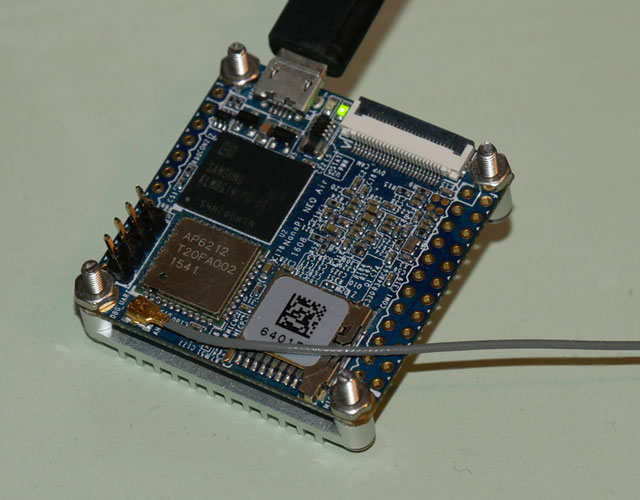

I have a NanoPi Neo Air (Allwinner H3 SoC) with onboard wifi and a serial interface. Unfortunately during some late hour hacking I managed to accidentally connect 5V onto its TX pin, I think effectively screwing up its UART0. I can no longer connect to it via a USB to TTL Serial cable (https://www.adafruit.com/product/954)
I think the SoC still seems to be working, I've flashed an ARM linux (Dietpi) to an SD card and when I powered on the Nano Pi Neo Air, it seems to have successfully expanded its filesystem.
With UART0 most probably dead, I wonder whether UART1 and UART2 would still work. Connecting a working USB/TTL serial cable to the board did not produce any output, my guess is that it needs to be enabled for the boot process.
As I don't have another Allwinner H3 board available at the moment (shipping takes weeks for us Europeans to arrive) I wonder if there's a way for me to enable UART1 and UART2 during boot. Did anyone manage to do this?

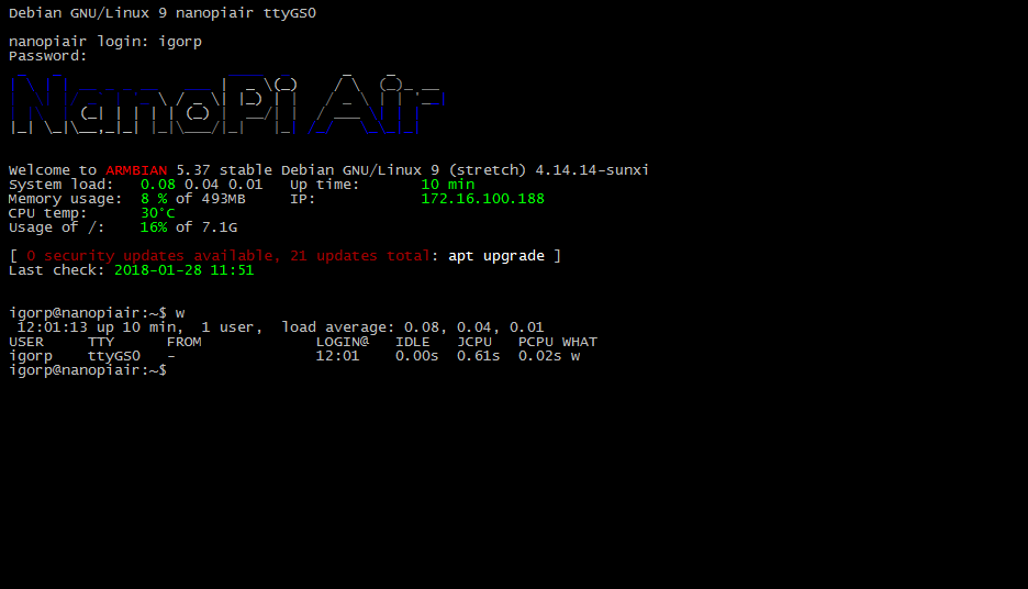

You can log in via microUSB serial. Just plug it to your USB port and a serial device will pop up on your host computer. It's not serial at boot time but you can login when system is up. Enabled by default.

Yes, but I also made a small mistake which prevented this working :( I manually enable USB OTG port while testing (within armbian-config), console popped up and forget about that. Now, this is fixed and the actual download image was tested - images at download were replaced, also for NanoPi DUO with the same problem. I don't know how this looks on MAC (USB3 port is recommended for powering, but USB2 will probably also work), but this way it looks on windows:
You can log in via microUSB serial. Just plug it to your USB port and a serial device will pop up on your host computer. It's not serial at boot time but you can log in when a system is up. Enabled by default.
