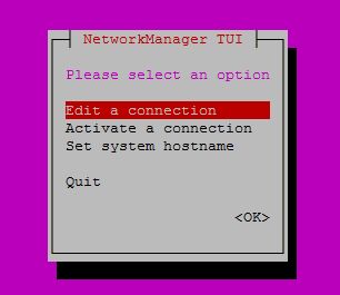

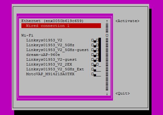

Used a DD command to copy the image to the eMMC so I had to start over. This time I found out what get's it on WiFi.
The /etc/network/interfaces file. I just did a cp /etc/network/interfaces /etc/network/interfaces~
Then vi /etc/network/interfaces and clear it all out what they have in there and copied a past the other post I put before this one.
Rebooted and it worked!
Did do the other one 1st /etc/wpa_supplicant/wpa_supplicant.conf and rebooted and still no IP on the WiFi.
So just use that same file but put your own wpa-ssid "name" in quotes. Same with the WiFi password wpa-psk in quotes.
To bad they don't install nano editor, Even there name start with that, nanoPi. So they should have it on this image and nmtui easy WiFi set up command. Looks like this when you type nmtui
nmtui easy command line WiFi.jpg (15.71 KiB) Viewed 51269 times
Got down one to Activate a connection and you see this at lest this is the WiFi mine picks up.
nmtui easy command line WiFi list.jpg (41.2 KiB) Viewed 51269 times
That would make it easy to set up WiFi and this nano pi air image should have that in it because besides RS-232 that is about the only way to connect to it.
-Raymond Day

Now that I have mine working good with room on the 8GB eMMC can install things. I installed the apt install network-manager Took a wile to install all it needed. But it worked.
After installing it had to start it.
service NetworkManager start
But go to activate and it's all blank on it's WiFi.
Rebooted and still did not fix it. I guess that's why they did not install it. Even the change hostname don't work on it. Just says did not change it.
-Raymond Day

Multi-manager will confuse the wifi configuration. That's why we don't install others networking setting tools.
Thank you
That's because network-manager gracefully ignores all interfaces defined the old/anachronistic way in /etc/network/interfaces.
Armbian for NanoPi Air ships with an empty /etc/network/interfaces and a serial console on the Micro USB port so you're up and running within 1 minute after booting due to nmtui making access to your network easy (no annoying wpa_supplicant stuff). Some performance numbers for some SBC: https://forum.armbian.com/index.php?/to ... es-on-sbc/
