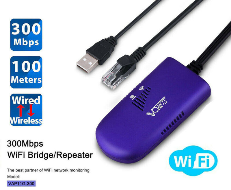

Directly not, but ypu can buy a WiFi Bridge (like Vonets) and connect the Air to the WiFi on the WiFi Bridge and on the other side of the bridge is a Ethernet-Connector....
