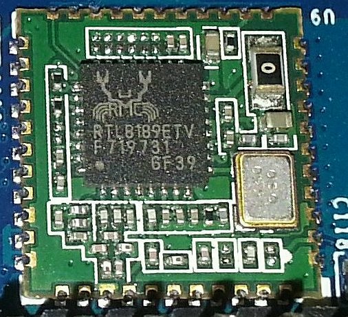

Isnt the rtl8189es a standard wifi module?
Attached a picture of the WiFi-Chip
Yes, it is enabled but it works only in a DEV branch. Don't know why not in 4.14.y
