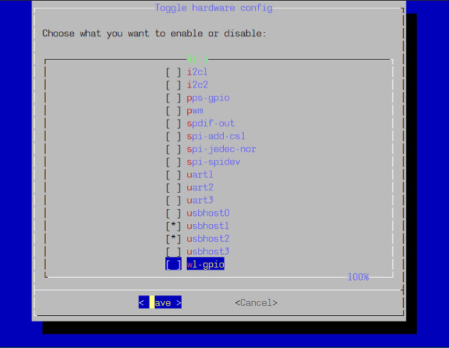

igorp wrote:
In armbian, you just need to enable them:
armbian-config -> hardware
on my NanoPi Neo(2) with the silver NAS case I have enabled usbhost1 and usbhost2 and all USB Ports are useable.
see the attached Picture
