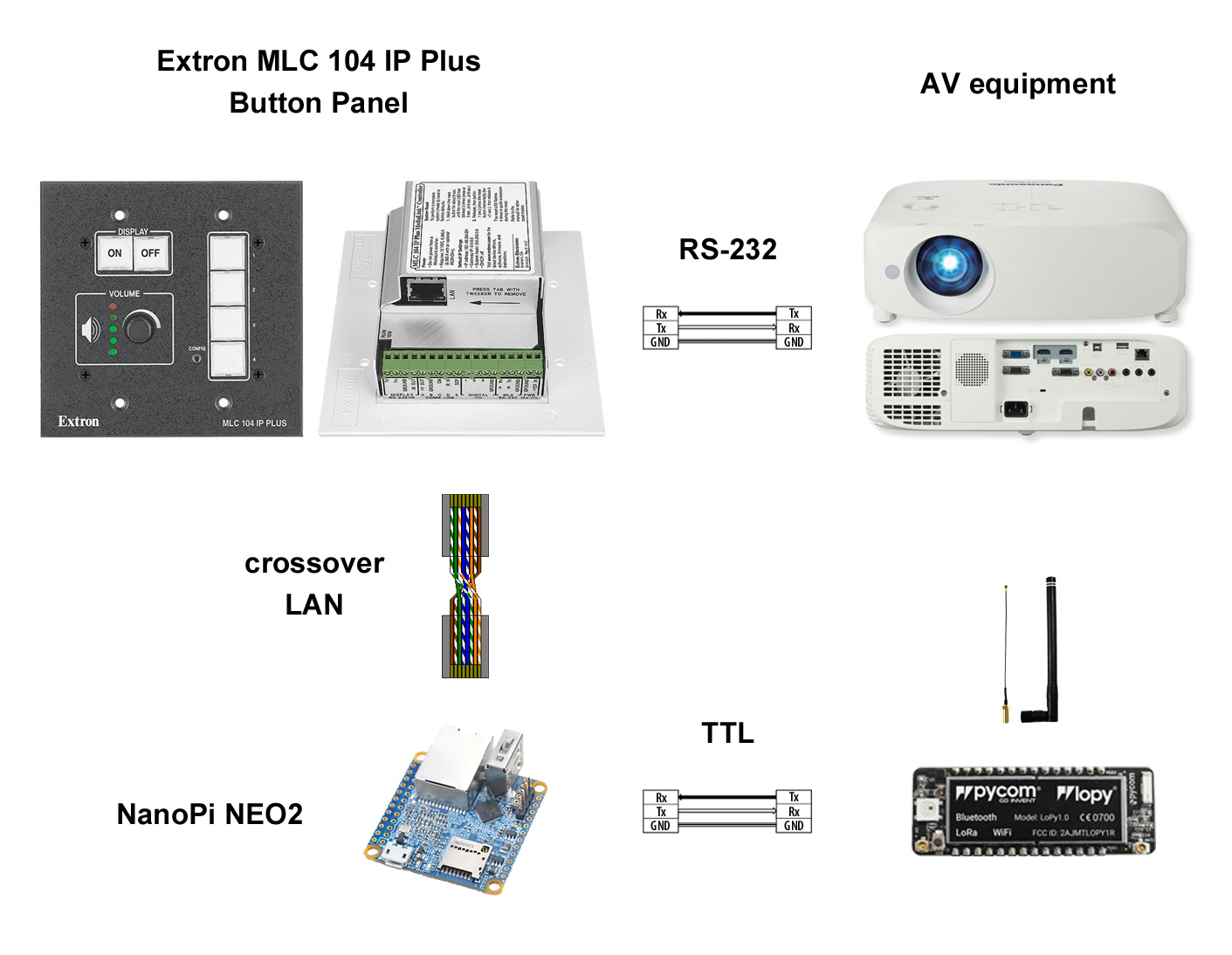

I was wondering (before I buy the NanoPi NEO2) if this is possible:
I want to sent Tx data and receive Rx data through the UART0 connector of the NanoPi NEO2, in combination with the Ethernet port of the NanoPi NEO2, Is this possible?
The Ethernet port of the NanoPi NEO2 is connected via a crossover cable to a button panel (with a RJ45/Ethernet connector). The button panel is triggerd by ASCII command (Tx), after a button is triggered an ASCII command (Rx) is sent back though the Ethernet connection... So I hope bi-directional TTL signal (telnet/ASCII commands) <> Ethernet is possible?
I hope someone has experience with this (nice looking ;)) tiny board and can sent a response if this is possible?
With kind regards, Jeroen Wolf
