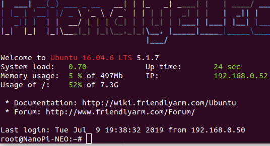

or update the kernel in a working distribution and customize it for yourself
2019-07-13 23-34-09.jpg (70.56 KiB) Viewed 24131 times
