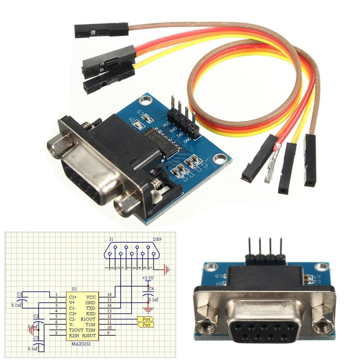

However, I went back and re-read your original post ... specifically about how you are wiring these two units. As far as I am aware a DB9 connector on a PC is a real RS-232 item, ie voltage levels like +/-15 Volts and you can not just wire them up to a UART running probably 3V.
So, do you have something between thee two units to provide a proper voltage interface?

For DB9 to the NanoPi serial Port you need a TTL-Levelshifter and 115.200 Baud
Thanks for the heads up! I didn't realize I need a voltage leveler. Is there any place I can readily pick up one?

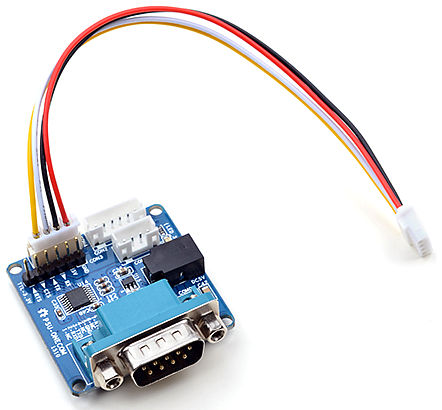

FriendlyArm's PSU-ONECOM
Good chance your NEO's UART has been damaged.
http://www.friendlyarm.com/index.php?ro ... duct_id=89
