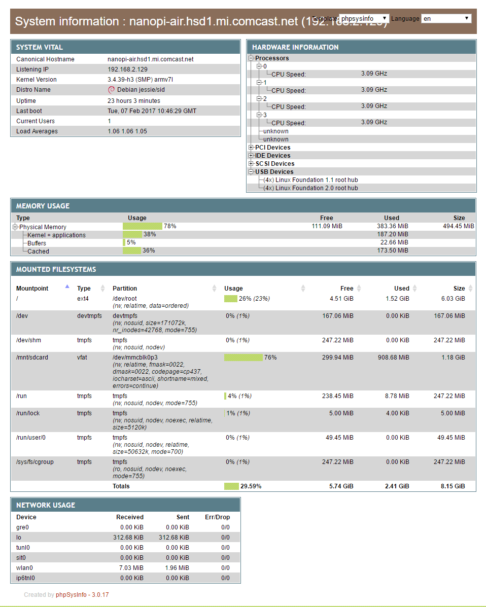

Never got it to work with the eflasher 8GB image to flash it's self to the eMMC. So like I said in another post I used Gparted to edit the SD card and made partition 3 the one it puts on /mnt/sdcard to only 1.18GB in size to the end of that partition then made the main / or the rest of the size so 6.03GB got it.
Now it don't say 99% full or even 100% used.
Here is a phpsysinfo screen of min how it looks now. Neat info to see on it.
screenshot-nanopi-air 2017-02-08 04-50-24.png (136.55 KiB) Viewed 37866 times
Can see the Mountpoint on this good how it's using the 8GB eMMC now.
-Raymond Day

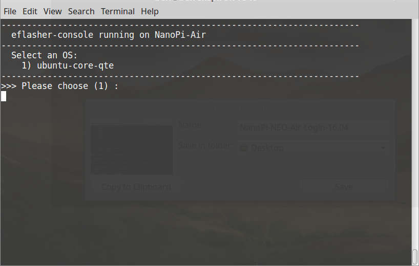

I tired this but all you get in the terminal is:
  eflasher-console running on NanoPi-Air
  Select an OS:
    1) ubuntu-core-qte
>>> Please choose (1) :
The wiki says: "Select your wanted OS and type "yes" to start flashing. After it is done take off the card, reboot your board it will boot from eMMC. "
When I press 1, nothing happens.

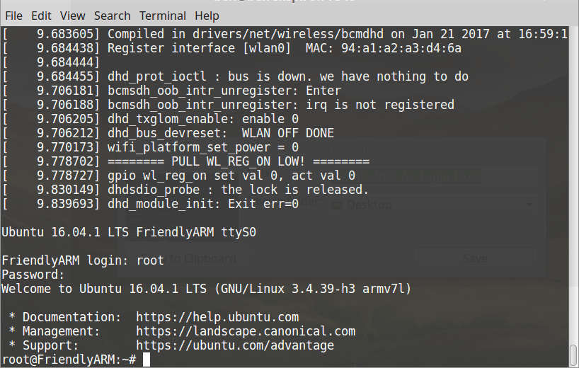

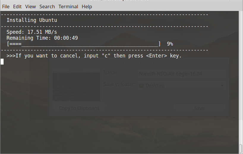

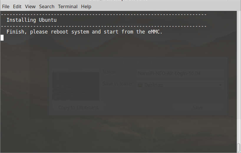

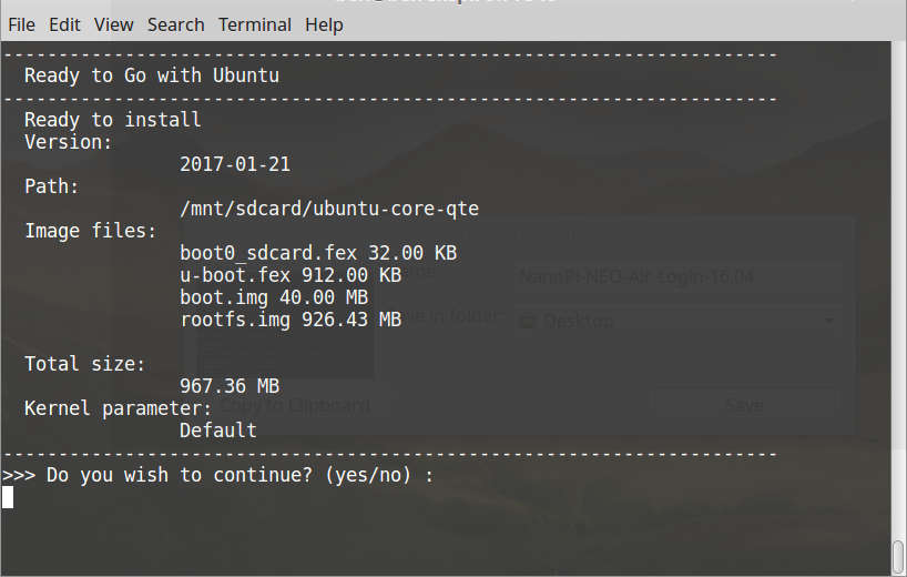

Hi, All
Here I post what I do successfully.
I use this ROM
[img]
[/img]
[img]
[/img]
[img]
[/img]
continued...
