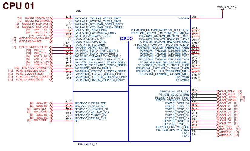

The debug UART is wired up directly at the SOC as can be seen by the schematic. The IO is powered by the VDD_SYS_3.3V power domain, so a USB serial adapter operating in the same power range is required. A TTL variant (5.0V) will not work. The VDD_5V pin of the debug connector is not related to the UART communication, it can serve as a power source for an externally connected device.
