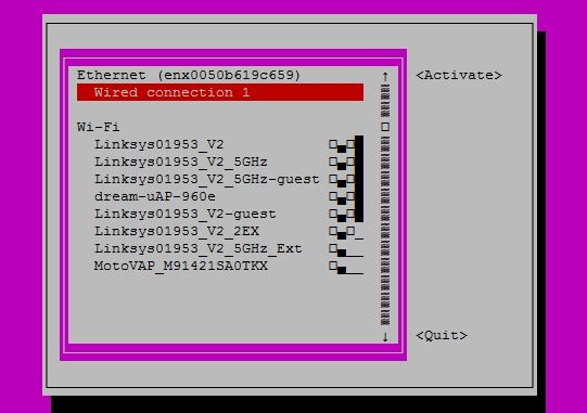

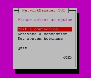

Used a DD command to copy the image to the eMMC so I had to start over. This time I found out what get's it on WiFi.
The /etc/network/interfaces file. I just did a cp /etc/network/interfaces /etc/network/interfaces~
Then vi /etc/network/interfaces and clear it all out what they have in there and copied a past the other post I put before this one.
nmtui easy command line WiFi.jpg (15.71 KiB) Viewed 51259 times
Got down one to Activate a connection and you see this at lest this is the WiFi mine picks up.
nmtui easy command line WiFi list.jpg (41.2 KiB) Viewed 51259 times
That would make it easy to set up WiFi and this nano pi air image should have that in it because besides RS-232 that is about the only way to connect to it.
