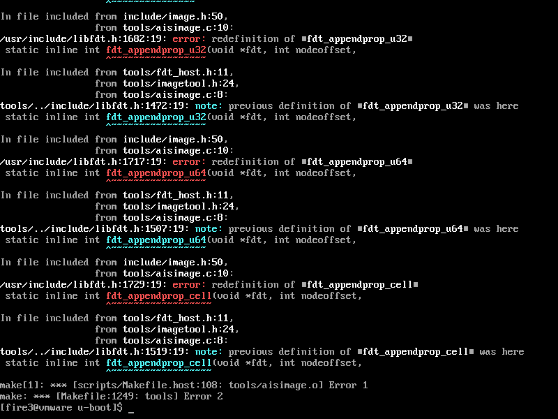

Hi! I would like to compile u-boot but get following errors. Could you please give me a clue how to solve them? Thank you!
ArchLinux Other Linux 4.x or later kernel 64-bit-2018-06-02-21-26-41.png (20.62 KiB) Viewed 46144 times
I got normal log of my build, hope it will help to figure out what the problem I have.

In file included from tools/fdt_host.h:11,
                 from tools/imagetool.h:24,
                 from tools/aisimage.c:8:
tools/../include/libfdt.h:1092:19: note: previous definition of ‘fdt_setprop_inplace_u64’ was here
 static inline int fdt_setprop_inplace_u64(void *fdt, int nodeoffset,
In file included from include/image.h:50,
                 from tools/aisimage.c:10:
/usr/include/libfdt.h:1237:19: error: redefinition of ‘fdt_setprop_inplace_cell’
 static inline int fdt_setprop_inplace_cell(void *fdt, int nodeoffset,
tools/../include/libfdt.h:1104:19: note: previous definition of ‘fdt_setprop_inplace_cell’ was here
/usr/include/libfdt.h:1303:19: error: redefinition of ‘fdt_property_u32’
 static inline int fdt_property_u32(void *fdt, const char *name, uint32_t val)
tools/../include/libfdt.h:1170:19: note: previous definition of ‘fdt_property_u32’ was here
/usr/include/libfdt.h:1308:19: error: redefinition of ‘fdt_property_u64’
 static inline int fdt_property_u64(void *fdt, const char *name, uint64_t val)
tools/../include/libfdt.h:1175:19: note: previous definition of ‘fdt_property_u64’ was here
/usr/include/libfdt.h:1313:19: error: redefinition of ‘fdt_property_cell’
 static inline int fdt_property_cell(void *fdt, const char *name, uint32_t val)
tools/../include/libfdt.h:1180:19: note: previous definition of ‘fdt_property_cell’ was here
/usr/include/libfdt.h:1510:19: error: redefinition of ‘fdt_setprop_u32’
 static inline int fdt_setprop_u32(void *fdt, int nodeoffset, const char *name,
tools/../include/libfdt.h:1330:19: note: previous definition of ‘fdt_setprop_u32’ was here
/usr/include/libfdt.h:1545:19: error: redefinition of ‘fdt_setprop_u64’
 static inline int fdt_setprop_u64(void *fdt, int nodeoffset, const char *name,
tools/../include/libfdt.h:1365:19: note: previous definition of ‘fdt_setprop_u64’ was here
/usr/include/libfdt.h:1557:19: error: redefinition of ‘fdt_setprop_cell’
 static inline int fdt_setprop_cell(void *fdt, int nodeoffset, const char *name,
tools/../include/libfdt.h:1377:19: note: previous definition of ‘fdt_setprop_cell’ was here
/usr/include/libfdt.h:1682:19: error: redefinition of ‘fdt_appendprop_u32’
 static inline int fdt_appendprop_u32(void *fdt, int nodeoffset,
tools/../include/libfdt.h:1472:19: note: previous definition of ‘fdt_appendprop_u32’ was here
/usr/include/libfdt.h:1717:19: error: redefinition of ‘fdt_appendprop_u64’
 static inline int fdt_appendprop_u64(void *fdt, int nodeoffset,
tools/../include/libfdt.h:1507:19: note: previous definition of ‘fdt_appendprop_u64’ was here
/usr/include/libfdt.h:1729:19: error: redefinition of ‘fdt_appendprop_cell’
 static inline int fdt_appendprop_cell(void *fdt, int nodeoffset,
tools/../include/libfdt.h:1519:19: note: previous definition of ‘fdt_appendprop_cell’ was here
make[1]: *** [scripts/Makefile.host:108: tools/aisimage.o] Error 1
make: *** [Makefile:1249: tools] Error 2
I send more time tracking this errors. My original build environment was Arch Linux on VMware virtual machine. I setted up Ubuntu on VMware virtual machine and got everything compiled just fine.
The only difference I see between these two setups is that Arch Linus has device-tree-compiler executable and C header files right in one package (https://www.archlinux.org/packages/comm ... 86_64/dtc/) while Ubuntu separates them as device-tree-compiler (https://packages.ubuntu.com/bionic/amd6 ... r/filelist) and libfdt-dev (https://packages.ubuntu.com/bionic/amd6 ... v/filelist), the last one maybe is not installed, need to check.
Maybe that lid to conflict of inclusion of two different definitions for fdt64_t:
typedef uint64_t FDT_BITWISE fdt64_t;
typedef __be64 fdt64_t
one comes from u-boot internal definition and the other one comes from Arch Linux /usr/include/libfdt_env.h.
Same time Makefile supposed to handle the presence of both definitions, but something goes wrong.
I would quite appreciate any hints on how to get u-boot to compile on Arch Linux as I am more familiar with this environment and my goal is to get Arch Linux running on Fire3.
