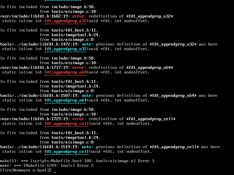

I am building same target and got errors while building u-boot
ArchLinux Other Linux 4.x or later kernel 64-bit-2018-06-02-21-26-41.png (20.62 KiB) Viewed 34400 times
Any suggestions what can produce these errors are very welcome!
