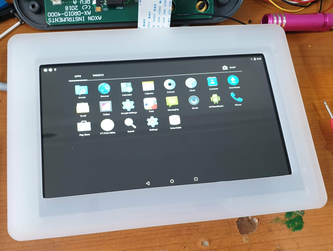

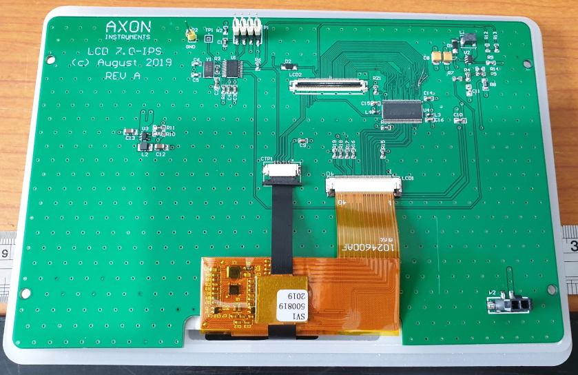

Here I have designed with a Newhaven 7.0" high brightness LCD as the existing HD702 is not bright enough (900 cd/m2 compared to around 300 for the HD702). This is 1024x600 and IPS so the viewing angles are very good. The display is LVDS so I have an RGB to LVDS conversion on the PCB behind the LCD. This is similar to the one used on the HD702 but this LCD only requires a single 3.3V supply so makes the PCB layout much simpler. Because the traces are so short, I have not had to do any length matching on the LVDS lines and the display is rock solid.
The LCD frame I machined from acrylic was the same dimensions as the current HD702 on so that it can fit into existing enclosures. I have also machined 2 more from black and white Delrin which looks much better as the colour is denser.
I had to modify the kernel and u-boot to include the timing for this display. I am still waiting for FriendlyArm tech support to help with the 1-wire side as I need a custom ID so that the display is an automatic selection. So far they have not replied to me on this. Shame, as I see lots of potential for their boards with my own custom LCD's. It just means I can't have a fully automatic LCD selection and have to write a customer kernel for each LCD I use. :(
