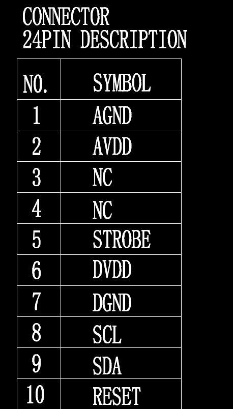

Another camera with OV5645 24pins (no confirmed compatibility with boards and any OS, just that is MIPI).
Does anybody knows is is possible to adjust any of them from 26pins/24pins to 30pins and by whom/where?
I will try to attach spec sheet from 24pins one that was provided (unfortunately the specs sheet for more promising 26pins is not provided by seller).
