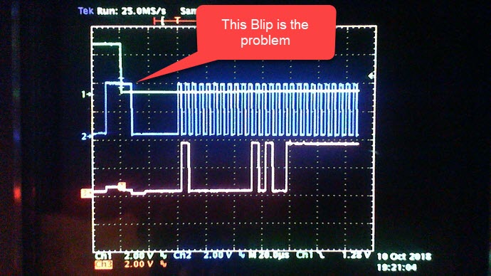

Using SPI on the Neo Air SPI does not work properly. The clk line is not stable low after CS goes low as you can see here.

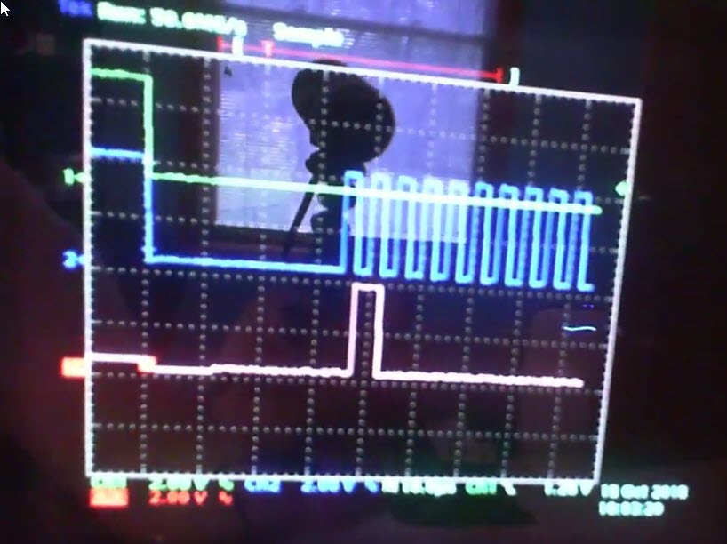

Here is the scope capture running the same python code on the Neo Core2, which works fine, as can bee seen here.
