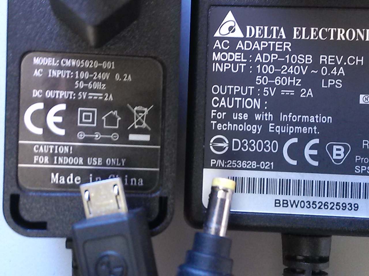

Got new PSU to test, so the problem is not the microUSB, i powered the board using only the PSU-ONECOM and the problem still exist.
The problem must be in the "EDID", broken?.
[attachment=0]PSU_microUSB_ONECOM.jpg[/attachment]
