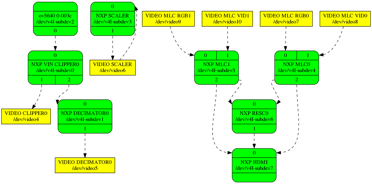

With the tool mediactl I created a png file with graphics. (attached)
The /dev/video4 should be the right one (and /dev/v4l-subdev2). But they wont work until mediactl does actually connect them.
After created the medictl script I will post it here (or better to wiki?).
